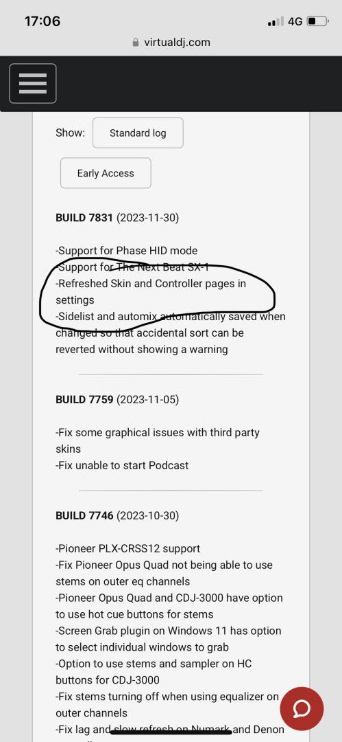

hi, where is in setting? And this refresh is for Denon Dj Prime 4 (for example) when file .xml (skin) change and doesn’t need to close the software and restart it to see the changes in the skin?
Thanks
not a script, it's how the interface & mapping windows have changed visually

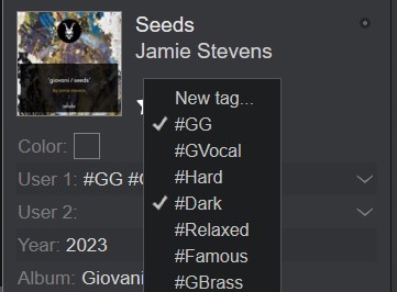

Hi everybody,
Question: Is there a script verb, that kann add, remove, or toggle hashtags on the browsed song. I mean the tags you can add for User 1 and User 2 field.
For me a toggle would be important. Like it can be done in the info bar done by click on the hashtag.
But as a script. Maybe something like
browsed_song_hashtag '#GG' which will add tag '#GG' if not present or will remove the tag, if it was present before.
I wish nice holidays to the team and everybody else!
Cheers Jochen

It's on a tag, so you can check the tag and add to the tag with
param_contains 'HASHTAG' `get_browsed_song 'TAG'` ?
if false you can add with
browsed_song 'TAG' 'HASHTAG'
If true, removing part of a tag is not possible with script, but I do have a windows plugin that can do this.
